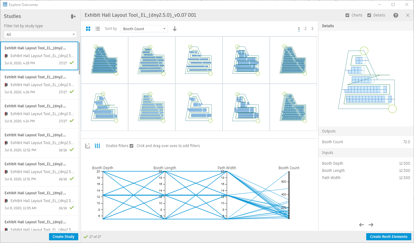

Obviously this is a great goal in 2017 in a Pre-Pandemic environment, however is not necessarily conducive for where we are in 2020 when Covid-19 cases are on the rise. So if we're to start entertaining the idea of allowing conferences and exhibit halls to start occurring, what are some metrics we would have to take into account? This is exactly what we wanted to explore with our client TVS Design. One such metric was to infer a generative design for one-way isles for booth traffic. That said we need to take into account egress, and can't have too long of an aisle, so we also implemented shortcut paths for people to navigate the halls faster. The algorithm is able to be fed an exhibit hall perimeter, and explore the metrics of
  • Booth Depth
  • Booth Length
  • Path Width
  • Booth Count
Next we run simulations with one-way arrows to identify congestion and bottlenecks. We can also apply a heat map post-simulation.
