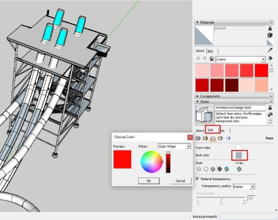

2. Also, it is a best practice, but not always necessary to ensure all faces are oriented outward for solids. Changing the face Back Face color to red will assist in determining which faces need flipped with the Reverse Faces tool. 3ds Max may have a hard time displaying the geometry if its faces are reversed.
